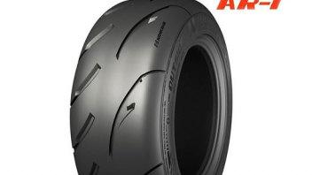

  • No they are not similar to real slicks! Its a Semi from China, but not cheap! The first tyre you could really use from Nangkang. I do have them for street driving. I think they are heavy! Next time i go with Federal RSR 595 again.

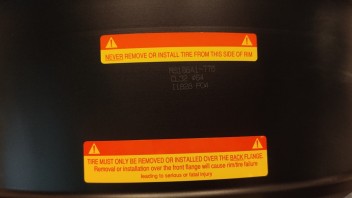

  • Hi - so revisting this thread.
    I recently bougth some Pirelli slicks but we could not mount them on the Racing wheels. Apparently the XBow wheels have a strange 'lip' that the pirellis could not mount on.
    Apart from the standard Michelins, which other Slick brands work with KTM wheels?
    Hello,
    I just bougth Racing wheels as well, and there is this warning inside all rims :
    Tire installation seems to be inverted compared to standard.
    I installed many tires on different rims and I never saw that ever. Maybe linked to "strange lip" you speak about...
    I don't have bought tires yet, I would like to resolve this mistery first :) (But surely Yokohama A052 if compatible)
    Does anyone know why it would be dangerous to install tire from front side of rim ??
    What special these rims are ?
    Thanks for reply.
