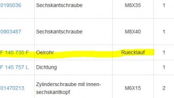

  • So after initial excitement it started leaking oil much more than before, the whole diffuser was covered in oil. So I replaced all four washers on the turbo oil feed line (number 9 on the drawing) and I replaced both seals on the turbo oil return line (number 20 on the drawing). Then I noticed that there are 2 bolts missing on the turbo! You can see it on the attached picture. I'm baffled that someone could install a turbo with half the bolts missing on my car, well shit happens I guess. These bolts hold the turbine and compressor part together. Sourcing the bolts turned out rather difficult, because Audi/VW dealer can't order them, because they can order only the whole turbo and they can't even see what parts it's made of - the policy is changing one turbo with another and never repairing them at the dealer/service. Luckily I managed to get them from a local turbo shop, but only because they happened to have some leftover ones. Unfortunately it's not possible to re-install both of the bolts with the turbo mounted on the engine, only one can be reinstalled - I don't have tools to take out the whole turbo so the last bolt is still not attached.
    Took the car for a test drive, drives fine but it still leaks oil. The source of the leak seems to be the necklace because that's where the oil drops form - see the picture. What do you guys think? Do you think it's leaking because of the last missing bolt or because of some inner seal that's worn? What would you do?
