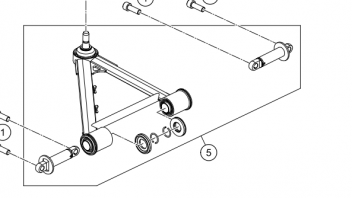

ok thanks, that was what i fear, was hoping that i could change all bushing, but just found out that Tom offer that service
https://www.willhaben.at/iad/k…ngsbuechsensatz-704581963
but rew some speciel tools to take whisbone of -
Hi everyone
my rear left wishbone , are tired in the bushing. is it only change the whole wishbone, or is it possible to get the bushing alone ? , i could not fint them in the spareparts catalog
