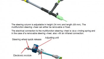

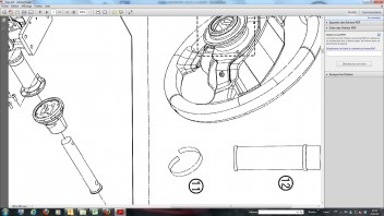

I have found this
i think I would try to remove the top part to look what is the problem
I hope I will not have problem with the electronic module
nobody could answer me ?
Somebody know how is the communication between Multifonctionsteering and display or ECU ?
I don t think it's with cable inside the steering colum... maybe infrarot
for me the play is between the part with the 6 screw and the steering colum
it's very strange....
but if you have a look to the picture we can see that this parts is attached to the steering colum
i don't think it's inside the steering column

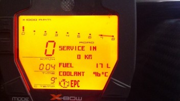

Hello
Ich habe eine mil error und epc error in kleine am Boden des Tacho.
Das error ist when ich habe nur die contact on aben nicht when das motor lauft.
Was ist das probleme ? das ktm fahrt gut
