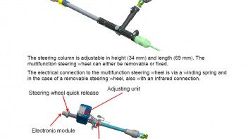

Somebody know how is the communication between Multifonctionsteering and display or ECU ?
I don t think it's with cable inside the steering colum... maybe infrarot
nobody could answer me ?
The removable steering wheel operates with infrarot, that's all i know... ![]()
I have found this
i think I would try to remove the top part to look what is the problem
I hope I will not have problem with the electronic module
