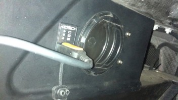

The ktm battery is very difficult to access
I decide to make a charging system easy.

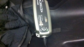

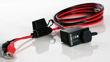

I order a Ctek charger MXS 5.0 and a comfort indicator pannel.

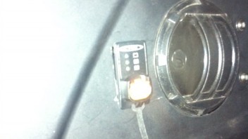

I found a good place to install the comfort panel... on the side of the heater.
Now It's very easy to connect the charger.... only plug into the pannel.

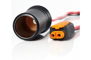

I can also insert a cig socker adaptator from ctek
