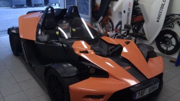

OK our windshield prototype............

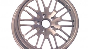

front 8,5 kg
rear 10,2 kgWheels are very light on the perimeter. Because of efforts to make universal assembly (central and 5x112) is 0.5 kg more material in the center. Simply put, the force required to spin or brake the wheels are corresponding to wheels half kilo lighter.
Half inch wider 8x17 and 10x18 Aluminum forged and CNC finnished wheels. RACETOOL made to order from company supplying WRC, DAKAR and Formula teams. Very light, superstrong and top quality. Fits both 5x112 and central lock. Estimated price 2200 EUR without VAT. Nice discount for binding orders. 6 weeks delivery time.
Best regards,
Pavel
